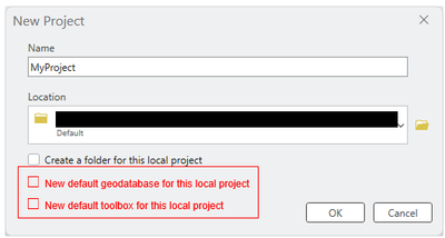

When creating a blank Pro project from the Create a New Project dialog, add two more options underneath the option to Create a new folder for this project -  one option - Create a New File Geodatabase with the ability to toggle on / off depending on whether you will need a new file geodatabase. The second option would be Create a New ToolBox with the same toggle on / off.
IMHO, it is just not necessary to have a new geodatabase and  a new toolbox for every single project I create.

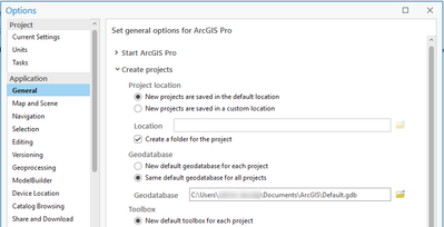

You can turn these off in 'Options > Application > General'.

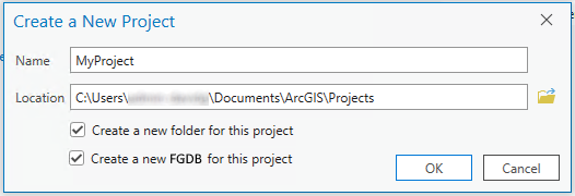

When creating a new Pro project, or saving a project started with the "start without a template" option, a Project default FGDB is sometimes not required. In this case, the "same default geodatabase for all projects" geodatabase is all that is required.
The option to change between creating a new FGDB and using an existing FGDB is made in Pro Options, which requires several clicks to update.
My idea is to add a toggle or checkbox to the "Create a New Project" and "Save Project As" dialogs to easily switch between the "same default geodatabase for all projects" and "New default geodatabase for each project" options. Similar to the "Create a new folder for this project" checkbox.
Here's an example of what the dialog could like like:
We're finding that all these unnecessary blank FGDB's that are being created are cluttering our file servers and Sharepoint sites. Something like this would help reduce the clutter.

One side point, in case some people are not aware of this option when creating new projects: instead of letting ArcGIS Pro create a default geodatabase and toolbox, you can designate a pre-existing geodatabase and toolbox for all new projects that you create from here on, by using the settings in the Options dialog (General tab, Create projects section). Note that you can change these settings any time and as often as needed.

Adding options to create a new geodatabase and/or toolbox in the "New Project" setup dialog box would be helpful. (This would override the default settings in Options.)
While these are both settings in the Options: General section, the choices are applied globally to all new projects. My projects are probably 50/50 whether I want to create a new geodatabase with the new project. If the Options setting is set to "New default geodatabase for each project," I end up manually deleting the geodatabase on half of the projects. Conversely, if the Options setting is set to "Same default geodatabase for all projects," I end up manually creating a geodatabase for half of the projects.
The Options setting could still be used to set defaults for these selections in the "New Project" box. However, it would be more efficient to allow the user to set up the new geodatabase and/or toolbox at project creation, based on the specific circumstances of the project being created.
