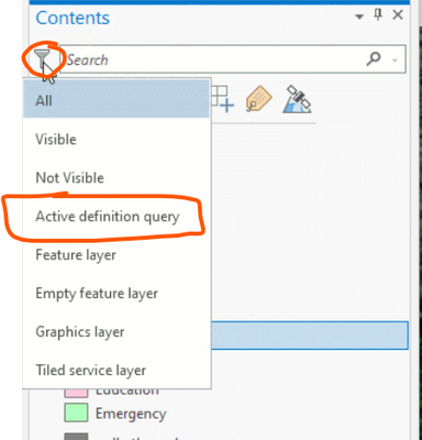

This idea is a duplicate of https://community.esri.com/t5/arcgis-pro-ideas/definition-query-icon-in-table-of-contents/idc-p/1089... See that link for how to filter the Contents to show layers with an active definition query.

See this part where you filter the layers in the Contents pane to show only those with 'Active definition query'  That way you don't need to click on each feature layer...  hope that helps!

@KoryKramer That does help! Thank you very much.
