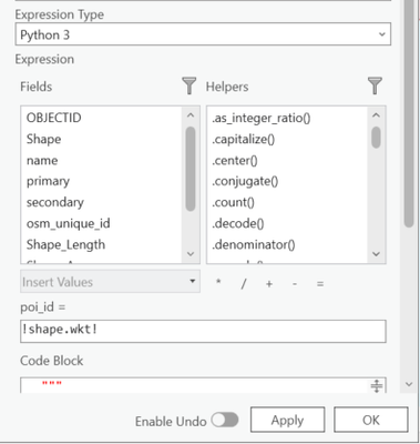

not sure if you are aware or not, but you can accomplish this by simply inputting "!shape.wkt!" into the python command a calculate field dialog.
