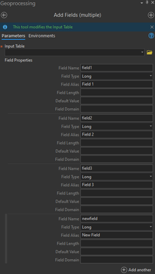

When configuring the Add Fields (multiple) tool, it's not possible to rearrange the order of new fields without removing the previous entries.
Example:
  1. I already filled out the tool with three fields - field1, field2, field3 - in my desired order.
  2. I add a new field - newfield - but now I want it to be ordered before field1.
  3. I would have to delete field1, field2, and field3. Then I would have to re-add them.
A less tedious process would enable me to drag and drop the new fields within the tool to fit my desired arrangement. This would be a quality of life improvement when building models or repeating processes from the geoprocessing history.

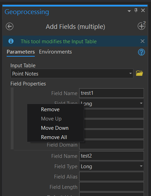

We have issues with drag and drop using multivalues, so for now there is no plan to implement this.
As an alternative, just right-click on the field and you have options to move the items. Right-clicking is not so discoverable, but across the Pro app has a lot of useful and timesaving contextual features.
