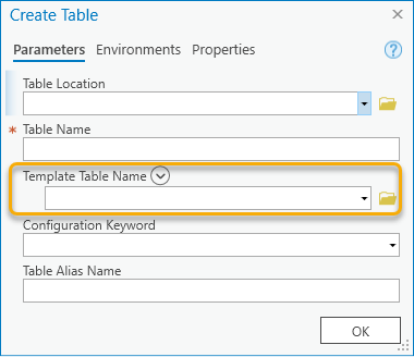

I'm building a ModelBuilder model and I want to re-use the fields in an existing geodatabase table to populate and then edit the "Add Fields (multiple)" GP tool.  I will craftily move those fields around to change their order ;-), change the definitions on a couple of them, remove some, and add some.  Do I want to manually enter all 79 (or worse) of those fields and risk going over the limit of however many clicks I have left in my carpal tunnels?  No, I do not.  Nope.  What I want is to import the fields from my template table to populate the "Add Fields (multiple)" GP tool and then burn some clicks on the arguably valuable changes.  Can I do it?  Nope, not yet in ArcGIS Pro 2.8.2 (2.8.3 is out, but release notes don't suggest an update would help me with this idea).  Would love to be able to do it soon.
Stringing up those two GP tools does not populate the "Add Fields (multiple)" field list.  Tried, failed.

Yes - nice that this has been implemented but....  If a field from the template table already exists in the input table it just errors and does nothing.  And there doesn't seem to be a way to say import all the fields except field1, field2 and field3.  Which seems like a slight oversight...  Is there a way?  If not I would like there to be. Now I have to manually input 38 fields.... still. 😑

@Michele_Hosking  thanks for your feedback. I observed the same error you described when one of the fields in the template table already exists in the input table. This is a defect, which has been logged with Esri Support as BUG-000166581.
This bug does not cover your feedback that you'd like to selectively choose which fields to add. If you are looking for that capability I think it might be better to use scripting. For example, you can specify the a list of fields to exclude (my list is Name and Type), while adding the remainder of fields to the input based on fields from the target.
