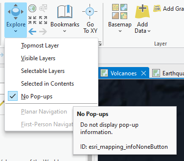

I wanted to add a note here that the No Pop-ups option was added to the Explore tool since this idea was posted. It doesn't specifically add the Disable pop-ups option to the context menu of a group layer, but it might help. As stated last year, you can multi-select layers and disable pop-ups on multiple layers that way.
