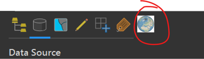

Hello Everyone !
Wheather you like it or not, maybe I just should throw out one feature to add this to the ArcGIS Pro.
It is about the coordinate systems.  I am aware that there is a way for you to open each layer and check their  coordinate system.
If you have many of them from different coordinate system, you have to open the the Map Propertis and
(See screenshot )
But how about add the similiar one and put it in the
Maybe in the future versions.

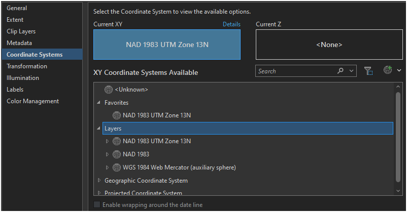

If nothing else, maybe Pro could provide the option to LIST/VIEW THE FILEPATHS to the layers listed under MapProperties-->CoordinateSystem-->Layers-->[CoordinateSystems], rather than just their TOC layer names (which can be duplicates, filepaths cannot, unless layer is loaded more than once)?
If not, I upvote the idea to list/order in TOC by spatial coordinate system. We work with a lot of farm equipment shapefile exports that are often named the same, so seeing 1 "culprit" layer named "Tile Pipe" with an Unknown system isn't particularly helpful when you have 1000+ layers named "Tile Pipe" loaded in the map and you need to merge etc.
Pro's project on the fly is handy but the need to get everything into a common spatial reference system for troubleshooting and pre-geoprocessing/analysis data prep hasn't gone away.

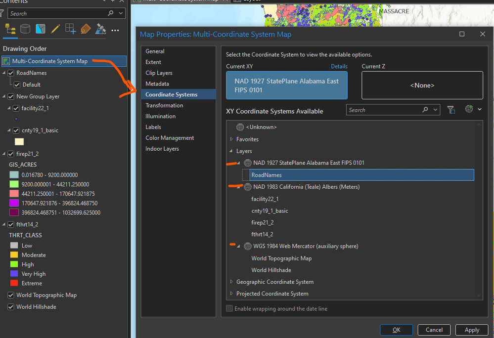

mj_gis
I was just looking for this functionality today and am really happy to have found this idea!
@KoryKramer  Thank you for describing how to see all coordinate systems in the map properties in Pro - so very  helpful.
Also I like @RoseF 's idea to list the layers that are being projected on the fly. That would be a very helpful addition.

KoryKramer
For troubleshooting and better understanding the various coordinate systems used by multiple layers within a map, you can go to Map Properties > Coordinate Systems:
