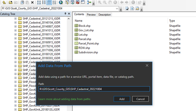

I use ArcCatalog for data browsing purposes, and to get data into Pro, I make heavy use of the Add Data from Path feature. I can easily copy the item's path from ArcCatalog's address bar and paste it into Pro. This works pretty well for one-off feature classes, gdbs, or shapefiles, but sometimes I want to add an entire folder, and it's not so easy to do. I either have to go in through Pro's catalog or copy the path for each individual layer/table. I would really like if Pro would just add the contents of a folder - whatever file types within are supported by GIS. I'm okay if it throws an error for non-GIS filetypes, but in cases like this, just add all the .shps to my map...

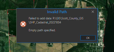

...instead of throwing this error.
