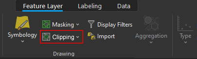

The introduction of the "Masking" option under Feature Layer > Drawing has been a major improvement for creating custom cartography. It however, falls short by not having the ability to accomplish the inverse at a layer level. There needs to be a "Clipping" layer option that functions exactly the same as Masking with the opposite results.
The "Clip Layer" option (still hidden) under Map Properties is very limited and doesn't give you the same flexibility needed. With it, you can only define 1 outline to use for the entire map which doesn't provide the same layer by layer customization found using the masking option. The purposed functionality would allow for the on-the-fly combination of multiple boundaries to form unique clipping areas. Plus, it would enable the application of different clipping boundaries to different layers in the same map. One could even apply both masking and clipping to a single layer to highlight certain areas without any extra geoprocessing. The options are endless from a symbology and labeling perspective if you have this flexibility.
There clearly are many workarounds to accomplish this, many of which require creating new features or manipulating your current data. But splitting features, adding additional attributes, creating snapshot copies of dynamic data, or manipulating data in general for cartographic reasons is not always the best approach from a data management perspective. Regardless, none of these approaches compare to the simplicity of clicking a check box that has no impact on the underlying data.

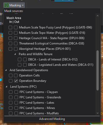

I can't believe this has sat here since 2011 without an update from ESRI on their intentions to either implement, consider or even ignore this request. We would value this change to the way the program works and can show our main use case below.
We produce maps in the remote West Australian areas that show land systems as the background, but only within the operation boundary. To achieve this at present, we need to ensure that the Operation  Boundary Layer has complete coverage over an area, and then instead of just querying the area we want displayed (the red boundary on the map), we have to have a second layer with the inverse definition query (everything not of interest) that is invisible in the symbology/100% transparent but then masks the land systems around the operational area.
My view of a solution - the option to select Masking either In (inside) or Out (outside) of a polygon layer:
