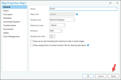

In ArcGIS 10.* when under the Layer Properties, we had an APPLY Button, this allowed us to see changes that we made before getting out of the Properties Windows.

I handle the mapping for the Municipalities for the entire State of Oklahoma, so I span 3 UTM zones, and the maps always look better squared up, plus it easier on the eyes when the map is square. So I usually keep the map at the middle projection, and just rotate the map accordingly.  being able to use the Apply button allows my to make fine adjustment without having to open up properties again for each tweak.
Steve
AmberConverse
@SteveOliver , I agree with you on how helpful it would be to have an Apply button.  I often have to change coordinate systems in a map, and then need to check transformation settings.  In Desktop, I could press "Apply" when I changed something in the settings, and see the coordinate shift on screen.  Then make another change to the settings, press "Apply", see the changes, and the Map Properties Window would remain open.
In Pro, I need to press "Ok" and the Map Properties Window closes, I need to re-open it, change a change, press "Ok" and reopen the Map Properties Window again for additional changes.  Its tedious.  But I find I often have to do it!

This Idea has been implemented in ArcGIS Pro 3.2. Please see the What's New documentation for more new features in Pro 3.2.
The Your Ideas in ArcGIS Pro 3.2 blog and video have been posted to the Esri Community blog. You can take a look at these to see your idea and all others that were implemented in this release of ArcGIS Pro
