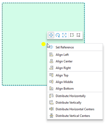

FYI @RTPL_AU you can align and distribute features with the Move tool (more info).
