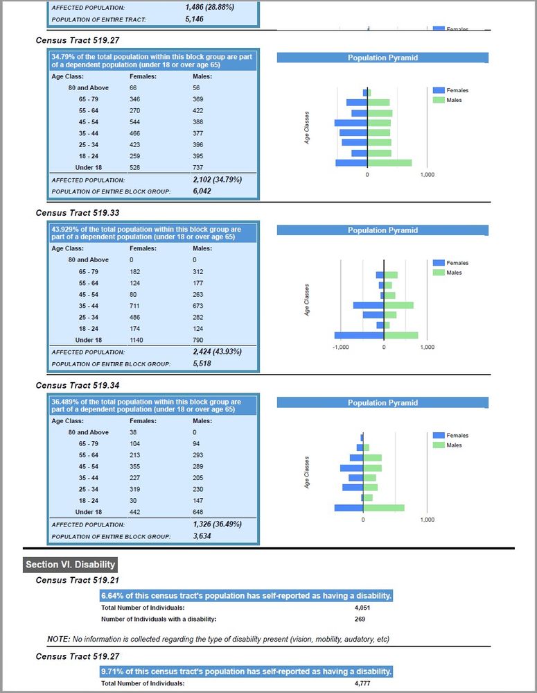

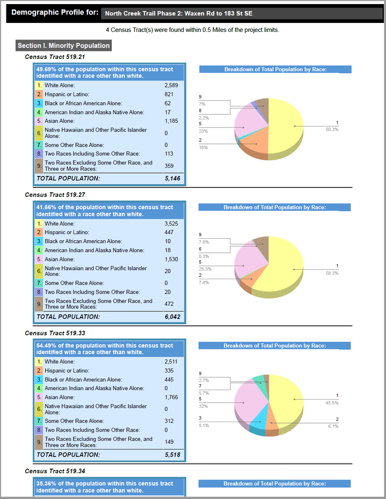

Alycia, while I disagree with the substance of your reply, I appreciate you offering the context for the current situation. Census data (with which I am working with) seems to be precisely the use case FOR the use of graphs inside the details section. I'll attach a copy of a report my JS API application generates as an example of what I'm trying to replicate and how the graphs work within the on feature context.
Based on your description of the current state of affairs, there's no point in my attempt to replicate this. Experience Builder export doesn't support this type of output export & suggests using custom report templates instead. Now you're telling me that it won't support that either. So now I'm stuck, still supporting a JS API application that we want to get off but can't.
