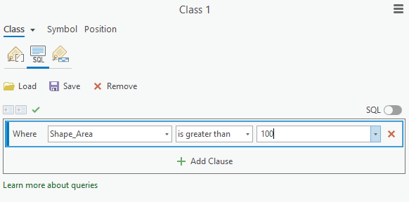

The functionality I would like to see falls in the SQL filter in the Label itself
Currently to see the label class without the filter I need to delete the query.

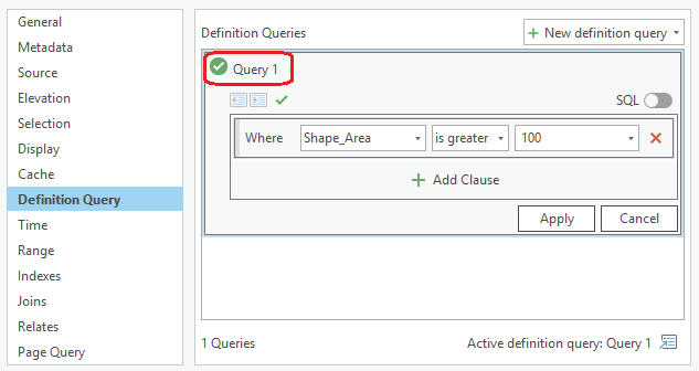

The Definition Query Documentation explains the idea of being able to Clear/Set Active filters using the tick icon in the green circle. See "Set the active definition query" section for the Definition Query Documentation, also screenshot below.

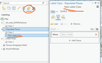

My recommendation in this case would be to create another label class and just toggle between the two classes

@MelissaBrooks Here is the documentation on using label classes - it isn't new.
https://pro.arcgis.com/en/pro-app/latest/help/mapping/text/label-classes.htm
You can have multiple label classes in place on a single layer. In order to "toggle" between them, if the hold the Alt key and click the checkbox next to the label class you want to display, it will only draw that class and turn all others off. Hold Alt and click the checkbox for a different class and it will only draw that one and turn all others off.
https://pro.arcgis.com/en/pro-app/latest/help/mapping/map-authoring/contents-pane-shortcuts.htm
Hope this helps.
