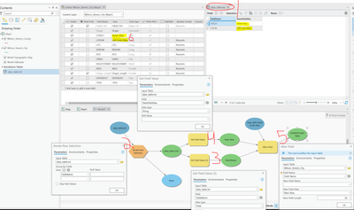

The suggestion from @DuncanHornby to use ModelBuilder with an iterator and the Alter Field tool is really good.
You can build a model that takes the alias table (1) as input, iterates (2) through each row which is a pair of one field name and the new alias, gets the existing field name (3) and new alias value (4) from the table row, and passes this into the Alter Field tool (5) to perform the alias update. You can see that my NewFieldAlias values have been used correctly and the layer has been updated with the new aliases (6).
