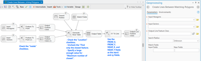

Hello AmrMortada,
Thank you very much for describing your use case in detail. It's indeed a good use of lines to visualize polygon relationships effectively.
For the time being,  BobBooth1 is right. You can easily make a model and use it as a tool in your workflow.  Here is an example model I made for your reference. I did it in ArcGIS Pro 3.7 so the model has the new look. Please let me know if you have any questions or need help to get it work.  - Dan

Hi @DanLee and @BobBooth1 ,
Thank you both for your time and for the helpful suggestions. I really appreciate you creating and sharing the ModelBuilder example, Dan.
I agree that ModelBuilder is a great workaround. My idea is simply to have this workflow available as a built-in geoprocessing tool, making it easier to discover and use without requiring users to build their own model.
