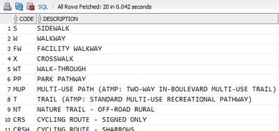

We can do it in enterprise geodatabases like Oracle EGDBs. What I do is create individual views to get the domain values (codes and descriptions) for a given domain.
create or replace view d_atn_type as
select cast(rownum as number(38,0)) as rownum_, x.code, x.description, i.name as domain_name from sde.gdb_items_vw i cross apply xmltable( '/GPCodedValueDomain2/CodedValues/CodedValue' passing xmltype(i.definition) columns code varchar2(255) path './Code', description varchar2(255) path './Name' ) x where i.name = 'ATN_TYPE'

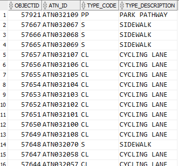

Then in a query/view where I'm selecting data from an EGDB table or FC, I join from the field that has the domain code to the domain view to get the domain description:
select
    objectid,
    atn_id,
    type as type_code,
    d.description as type_description
from
    infrastr.active_transportation a
left join
    infrastr.d_atn_type_vw d
    on a.type = d.code
