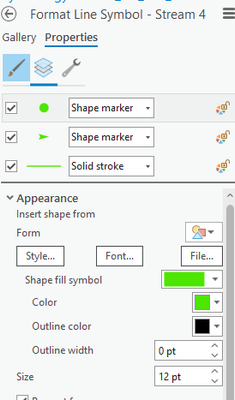

In ArcMap 10.X, the symbol editor was identical when you were editing 1 symbol, and when you were editing multiple symbols. In ArcGIS Pro, when you are editing 1 symbol you have access to the Symbol Tab, the Layers Tab, and the Structure Tab. However, when you are editing multiple symbols (via 'Symbology' pane> 'More' drop down> 'Symbols'> 'Format all symbols') you only have access to the Symbol Tab.

When Editing a Single Symbol (Unique Values)
Symbology pane when editing a single symbol in ArcGIS Pro 2.0.1 (polyline symbol as example).
Available Options
Feature TypeSymbol Tab OptionsLayers Tab OptionsStructure Tab Options
Point
Scale Based Sizing
Appearance
Halo
Appearance (for each Symbol Layer)
Position (for each Symbol Layer)
Rotation (for each Symbol Layer)
Offset distance (for each Symbol Layer)
Symbol
Layers
Polyline
Scale Based Sizing
Appearance
Line Width
Offset effect (for each Symbol Layer)
Dash effect (for each Symbol Layer)
Caps & Join (for each Symbol Layer)
Symbol
Layers
Polygon
Scale Based Sizing
Appearance
Pattern (for each Hatched, Gradient, and Picture Symbol Layer)
Symbol
Layers
