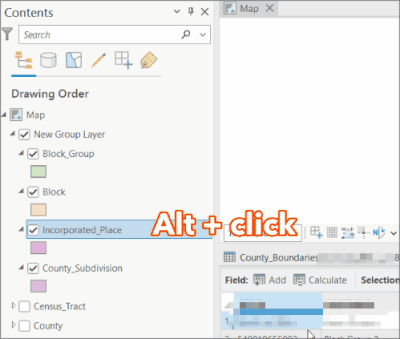

In addition to what Russ mentioned, I'd like to add (for people from the future) an age old keyboard shortcut that might have come handy in other workflows.
The shortcut is Alt+click. As you see in the animated gif below, it only makes the layer that you clicked on visible, and other layers get toggled off.
We also have a variant that is Shift + alt + click that turns off the visibility of all other layer from the entire map, whereas alt + click works only with a group layer. 
