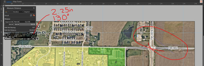

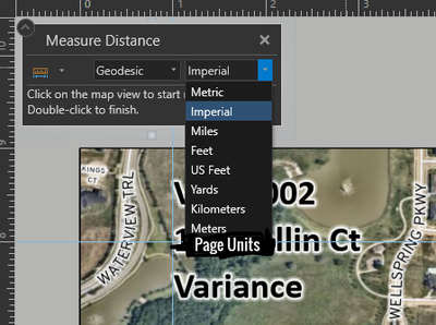

I have been making poster sized maps for print and I do a lot of manual labeling. It would be nice to have a measure tool to measure page units on the Layout. It is easy to measure distances and areas in map unit on the map frame but sometimes I need to measure the distance between two elements on the layout to determine the real world distance between them.
