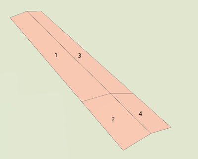

We need a 3D Dissolve tool that correctly handles 3D feature geometry. In my case, I need it for polygon features with z-coordinates (i.e. PolygonZ which have hasZ=True).
The current Dissolve tool will handle PolygonZ features, but all Z-coordinates will come out as zero values (which could be tagged as a bug, but it is currently handled as a feature).
This is what should happen:
We have four PolygonZ features. Polygons 1+2 are coplanair and adjacent, so are 3+4.
The coplanair adjacent polygons are dissolved into single features, which leaves use with two output PolygonZ features:
