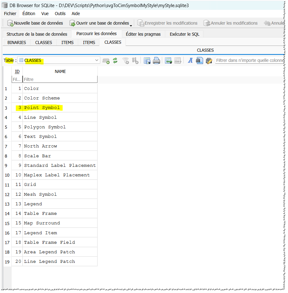

I used DB Browser for SQLite to take a look at the structure of the .stylx db. Most of what you need is stored in the ITEMS table. There's a content field where the json representation of the symbol is stored. For some reason, the json string has a character at the end that makes DB Browser think it's a blob instead of text. If you delete the 00 at the end, it will then display as text and you can get an idea of what the json looks like for a CIMPointSymbol for example.
Things to know about the .stylx file:
  • both ID and KEY have unique constraints, so make sure the rows you add to the database comply with these constraints
  • CLASS is the type of things your adding to the .stylx - I didn't investigate all the options, but I do know 1 is a color and 3 is a symbol

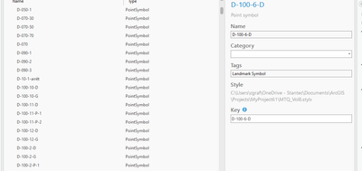

@RanaMuhammadRameez, @JimmyKnowles, when rolling the code, I see the name and key, but no images or icon?
All my PNG's are 220x200, it's there a size limit?

@CristianGraf Symbol size does no have any restriction. I am unable to test the situation due to inavailbilty of the environment. Have you tried to apply this symbology?

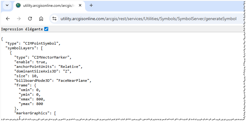

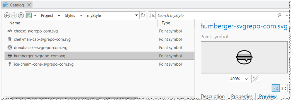

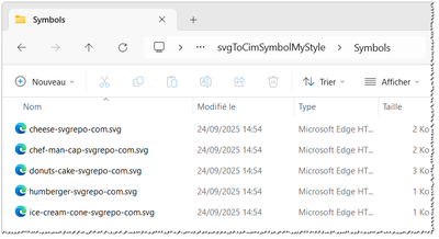

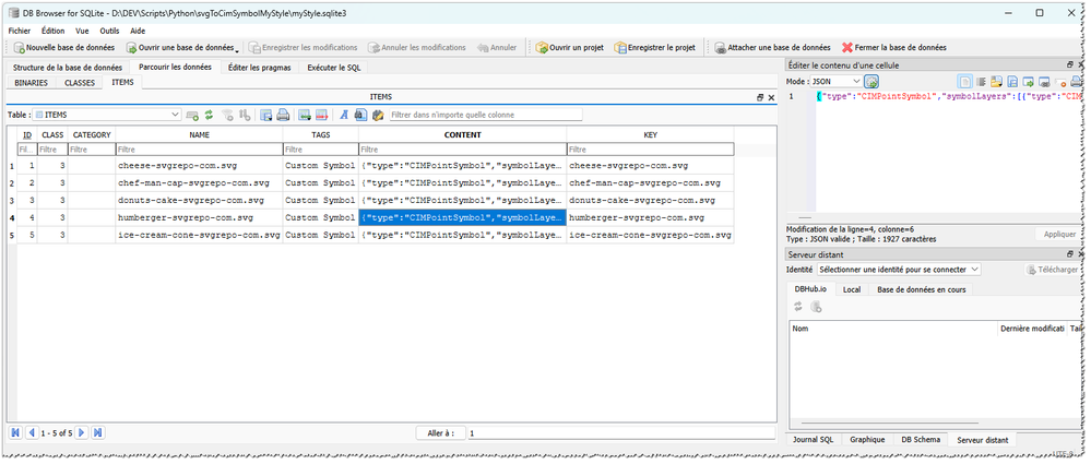

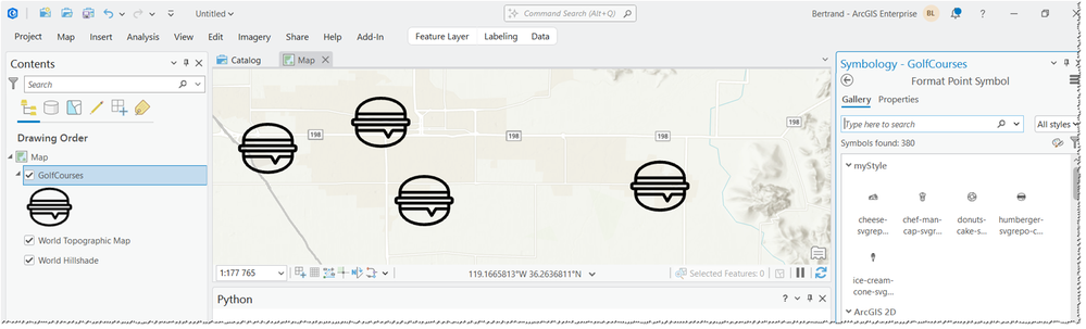

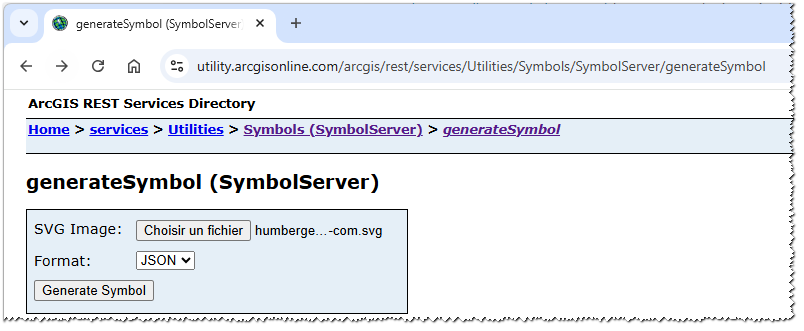

Python script to batch import SVG point symbols into a style file (STYLX)
The following script imports all SVG point symbols from a folder into a style file (STYLX).
import os
import sqlite3
import requests
# Path to the folder containing SVG files
folder_path = r"D:\DEV\Scripts\Python\svgToCimSymbolMyStyle\Symbols"
# Generate Symbol URL
url = "https://utility.arcgisonline.com/arcgis/rest/services/Utilities/Symbols/SymbolServer/generateSymbol"
# Connect to the .stylx file as a SQLite database
stylx_path = r"D:\DEV\Scripts\Python\svgToCimSymbolMyStyle\myStyle.stylx"
conn = sqlite3.connect(stylx_path, timeout=60)  # Timeout of 10 seconds
cursor = conn.cursor()
print("Connected.")
# Loop through all files in the folder
for filename in os.listdir(folder_path):
    if filename.lower().endswith(".svg"):
        svg_path = os.path.join(folder_path, filename)
        print(f"Found SVG: {svg_path}")
        with open(svg_path, "rb") as f:
            files = {
                "svgImage": (filename, f, "image/svg+xml"),
            data = {
                "f": "json"
            resp = requests.post(url, files=files, data=data)
            print("status:", resp.status_code)
            print("body :", resp.content)
            new_row = (
            3,  # CLASS (symbol class)
            "",  # CATEGORY
            filename,  # NAME

The SVG point symbols are located in the following folder:
The script uses the ArcGIS Online or ArcGIS Enterprise REST API (starting with version 11.0) and its generateSymbol operation.
This operation converts a Scalable Vector Graphics (SVG) image into a Cartographic Information Model (CIM) symbol. Source: https://developers.arcgis.com/rest/services-reference/enterprise/generate-symbol/
Example :
You can check that the symbols were correctly imported by copying and renaming the myStyle.stylx file to myStyle.sqlite.
Note: The myStyle.stylx file is simply an SQLite database.
Download DB Browser for SQLite and open the myStyle.sqlite database:
Note: You can see that the symbols have been successfully imported into the ITEMS table.
Note: The value 3 in the CLASS column corresponds to "Point Symbol" in the CLASSES table:
In ArcGIS Pro > Catalog View > Style > Add > Add Style :
