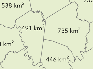

Superscript 2 in the Km squared label:
$feature.ALAND_KM2 + " km<SUP>2</SUP>"

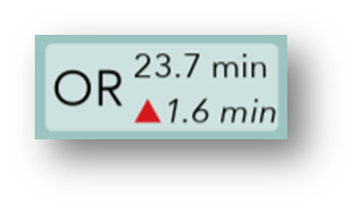

State labels with average commute times and change in average commute time since 2010:
var arrowStyle = "▲"; //Default all arrows to show an increase
if($feature.CommuteChange2010_2021 < 0) {
  //Change to decrease arrow if the change in commute time decreased from 2010 to 2021.
  arrowStyle = "▼";
//Configure values for the CLR (color) tag based on the size of increase or decrease in commute time.
var arrowColor = "red='253' green='174' blue='97'"; // small increase
if($feature.CommuteChange2010_2021 > 1) {
  arrowColor = "red='215' green='25' blue='28'"; // large increase
  arrowColor = "red='171' green='217' blue='233'"; // small decrease
if($feature.CommuteChange2010_2021 < -1) {
  arrowColor = "red='44' green='123' blue='182'"; // large decrease
//Use text formatting tags to:
// 1. Define the PARTs used in the Composite callout symbol grid.
// 2. Adjust font size of the state label with FNT tag.
// 3. Format numeric attributes using the Text function with a string pattern.
// 4. Set the arrow's color by inserting the parameters of the CLR tag set in the arrowColor above.
// 5. Put the commute time change value in italics with the ITA tag.
"<PART position='middle'>" +
"<FNT size='16'>" + $feature.STUSPS + "</FNT></PART>" +
"<PART position='right'>" +
Text($feature.MeanCommute2021, "#.#") + " min" + TextFormatting.NewLine +
"<CLR " + arrowColor + ">" + arrowStyle + "</CLR>" +
"<ITA>" + Text($feature.CommuteChange2010_2021, "#.#") + " min" + "</ITA></PART>"
