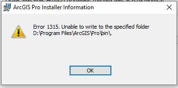

Hello, new user here.  Have tried to apply this patch via ArcGIS Pro interface and alternately by downloading the .msp file from My Esri.  On each occasion I receive the following message and the update fails.
The d: folder is shared with all users and I'm logged in as administrator.  Wondering if the error might be due to installing ArcGIS on a non-standard drive (d: instead of c:)?  Has anyone solved this issue?
