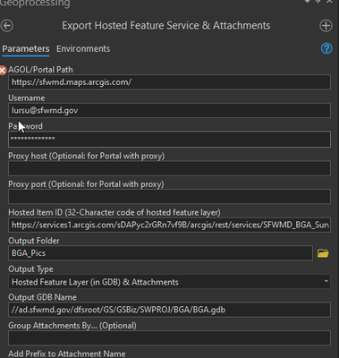

UriGilad_EsriAu
Hi Larci,
In the Hosted Item ID you only need to insert the 32-character code, not the entire URL.

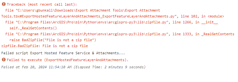

Very cool tool. I almost got it working but am stuck with the message:
chill_gis_dude
Has anyone gotten this to work for them lately?
I am getting error messages from the tool script: Capture.PNG
