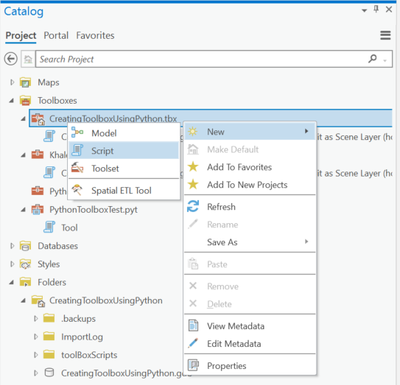

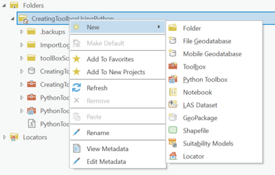

  1. In ArcGIS Pro create a new Toolbox
    1. In the Catalog window, navigate to the folder or geodatabase where you want the toolbox to be created. 
    2. Right-click the folder or geodatabase and click New > Toolbox. Then, you can enter the name for your toolbox; Here, I named it CreateToolboxUsingPython
  2. Right-click on the toolbox and click New > Script

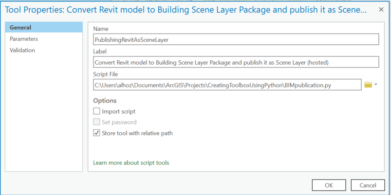

  3. The following dialog box pops up:
    1. Name - name of the tool
    2. Label - the label is the display name for the script tool (as shown in the Geoprocessing pane) and can contain spaces.
    3. Keep the Import script checkbox unchecked during the developing phase for testing purposes. After you finish the script and you are content with it, you can check the checkbox for embedding the script in the toolbox, help - Add a script tool

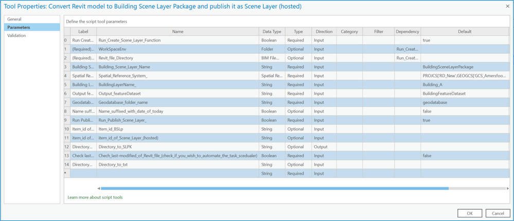

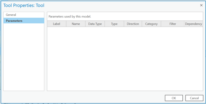

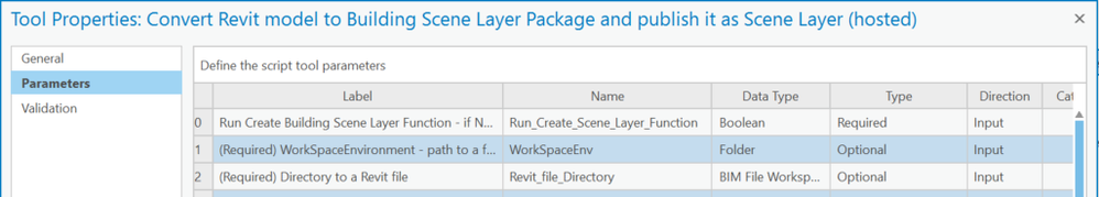

  4. Next you click on parameters > the following dialog box appears:
    1. In this documentation you can find a detailed description of how to define each type of the parameters. Here you can design the interface parameters for user inputs. That is basically the arguments that your function(s) take as input.  Tools Properties.PNG

  • In dialog box from step 4 (setting up developing environment) you can add Label, Name and other properties for the three parameters at hand.
    For example, as mentioned before, Run_CreateBSLpackage is a boolean parameter. Therefore, we cheese Data Type: Boolean. Type: Input. The rest of the properties is pretty much straightforward. This snippet shows the properties of the three parameters we defined above. Fill them out and click ok.

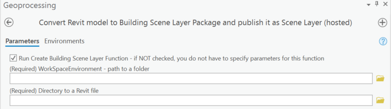

  • Click on the scripting tool in the catalog pane. Now the dialog box of the scripting tool should look something like this, and in the script the parameter takes its value from the geoprocessing tool interface. Note that some extra scripting is needed for getting the values in the correct datatype; for examples refer to the final script below. dialogbox.PNG
  • Now, define the inputs parameters through the wizard and click on KhaledAlhoz_0-1607522748236.png to test whether the workflow runs with no errors. If so, you continue with all parameters that should be taken as input from the user.
Once you've finished defining all parameters, and if you have worked on the same script; the tool should look similar to the snippet below. Now you can define the parameters and automate the process using the scheduler.
Geoprocessing script-tool  -  Publishing Revit model to Scene LayerGeoprocessing script-tool - Publishing Revit model to Scene Layer
Here are the final parameters' properties:

Let's take the same boolean input from example one:
run_CreateBSLpackage = arcpy.GetParameterAsText(0)
if run_CreateBSLpackage == "true":
run_CreateBSLpackage = True
else:
run_CreateBSLpackage = False
The wizard passes on the value in type string to the script, therefore, Python does not recognize Boolean (True of False) value. It simply read as a word true. There is a way around it, which is to simply change the value to Boolean, with if statement, as shown in the example above.
If you check the rest of the input parameters, you will find examples of dealing with other types of input from the wizard. Script (before and after) and the toolbox BIMpublicationtoolbox can be found in the attachments, for if you wish to develop them or use them directly. Note that the same files, which will probably be improved in the future, can be downloaded from the GitHub repo
