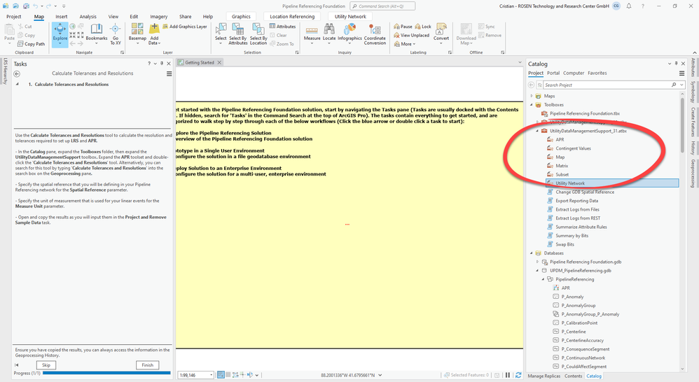

I just have a brand new machine, I just installed ArcGIS Pro 3.1.*, and I am opening the solution "Pipeline Referencing foundation".
Following the instructions to Prototype a single user environment, it states that i should calculate the tolerances and resolutions.
when I follow the instructions and go to the Catalog, looking for the APR toolbox, it does not open.
Is there any prerequisite to be able to open the toolboxes included in this solution?
Cristian_Galindo
Do not worry, I do not why I had to refresh the toolbox node in order to load the tools
