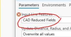

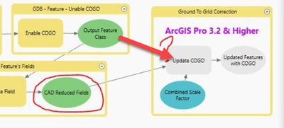

Hello @AmirBar-Maor ,
First I want to think you for this amazing video that I have watched multiple times and tried to adapt your model to my specific needs, but I keep running into obstacles. Specifically, with the Update COGO tool, in your model, it’s applied to the features in the geodatabase. However, when used manually, it’s typically applied at the CAD file level.
I attempted to apply the Update COGO tool directly to the CAD file, but it didn’t work. Following your model, I then tried applying it at the geodatabase level to the copied features from the CAD file. While the feature was exported, the scale factor still failed to apply.
Do you have any insights into what might be causing this issue?

What is the error tooltip that you get when you hover over the "CAD Reduced Fields"?
Could you test if it works when you supply it the previous 'Output Feature Class'?

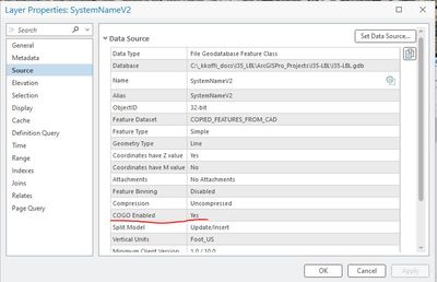

Thank you for your prompt response. The error I am getting is "Error 002044: this class is not COGO enabled" which is not accurate.
I have included images of the Log, the Error, and the Attribute table of the Feature.

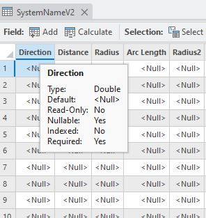

The right thing is of course to open a technical support case... For a feature class to be deemed 'COGO Enabled' all the COGO fields have to exist AND the all have to be 'required'.
Could you please open the attribute table of the feature class that got created and hover over the field name? You should see all COGO fields as 'Required':
Please also check that the feature layer properties show that it is 'COGO Enabled':
If they are not 'required'  that is why the Update COGO tool refuses to process them.
If it is not COGO Enabled the next step will be to figure out if COGO Enable fails or if they become non COGO Enabled by the Delete field tool.
Please share your findings.

Hello @AmirBar-Maor
Everything looks good on my end.
I  will go a head and send you the model.

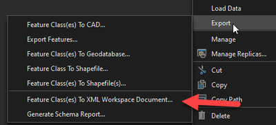

If anyone else is following this thread and encountered that the geoprocessing tool 'Update COGO' does not recognize the feature class as 'COGO Enabled' here is the workaround.
Instead of copying the data from the CAD layers to a new feature class append the CAD features to a COGO-enabled lines feature class. You can use these steps:
  1. If you are using the parcel fabric the line feature class is already COGO-Enabled. Else create a line feature class with the correct spatial reference and run the geoprocessing tool 'Enable COGO'
  2. Right click on the feature class and Export the feature class as a XML Workspance Document' (schema only).
  3. Every time you import a CAD file use the geoprocessing tool 'Import XML Workspace Document' to create a new COGO Enabled line feature class (or an entire feature dataset containing your staging parcel fabric).
  4.
    Use the geoprocessing append to append the CAD features to the COGO-Enabled line feature class.
Steps 1 & 2 are only performed once. Steps 3 & 4 for each CAD file you process.
