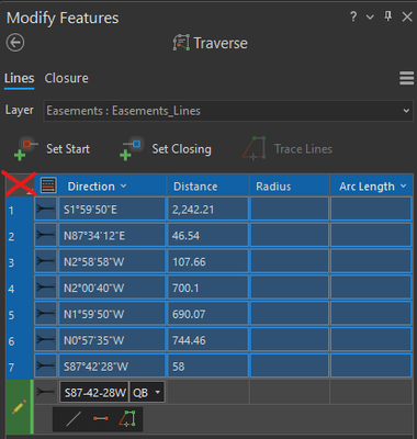

You can click on the box above the numbered lines to select all the lines in the traverse. I'm still using 3.3, hopefully that's still true for 3.5.
