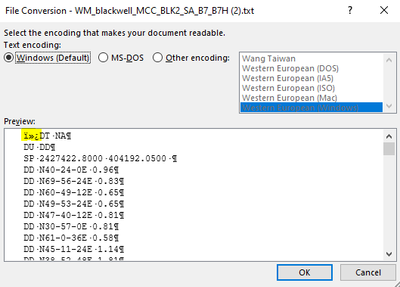

I have a well log deviation survey that I would like to load as a traverse file format.  I have matched the input format but an error is thrown when loaded.  the error message is not very helpful.  It is probably a value out of bounds or a hidden character in the file. If you have experience with traverse files please take a look and share your advice.

1) On line 1, invalid characters are embedded in the file.  Open the file and save it as TXT with UTF-8 encoding.
The header is incorrect for the data presented.  DT should be QB and DU should be DMS.

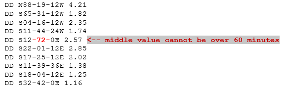

Also, on line 108, the traverse is noted as "DD S12-72-0E 2.57".  The center value cannot be over 60 minutes.  Delete or correct the transverse.
Please try the attached updated file.
