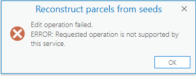

I'm getting this error message returned on the Reconstruct from Seeds tool.
I'm editing the parcel fabric through a feature service.  Is this tool not supported on a parcel fabric feature service or am I missing something?
ArcGIS Pro 3.0.3
fabric ver. 5
Enterprise ver. 11
Thanks.

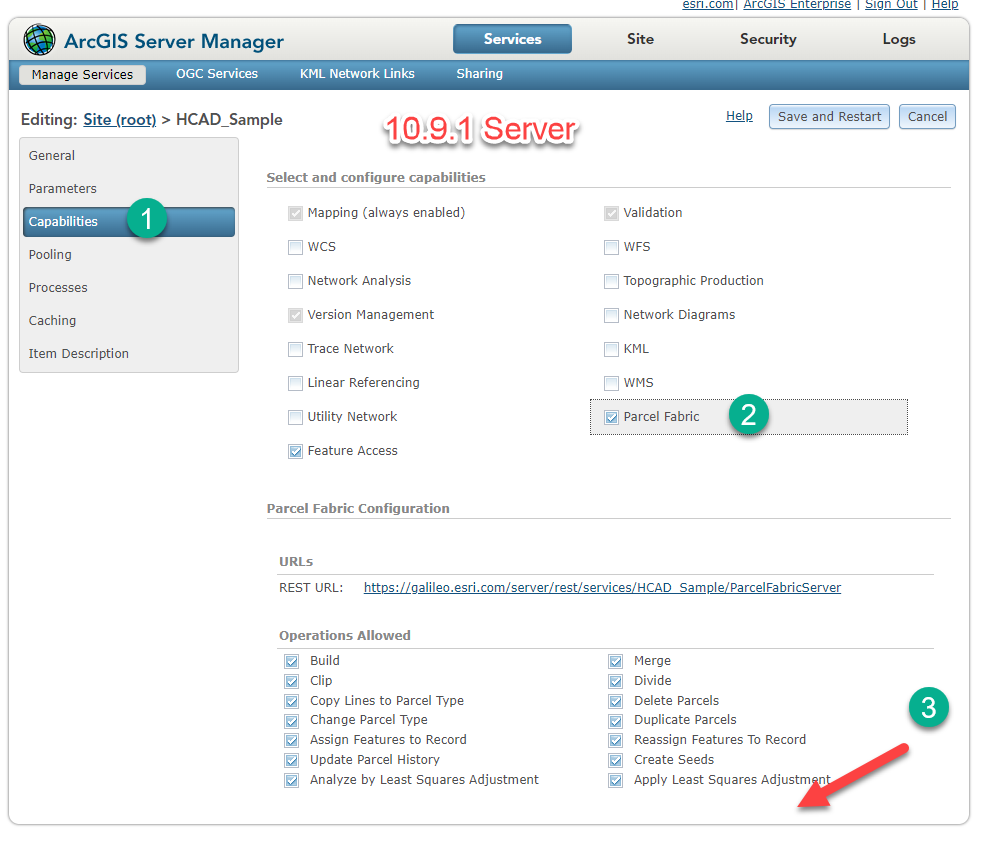

The capability to 'reconstruct from seeds' was added to Pro 3.0 and enterprise 11.0.
On your server manager, I would make sure the capability is checked on. The screenshot below is from ArcGIS Server 10.9.1 so that's why you don't see it.
As suggested, you can also test republishing and see if this solves the issue.

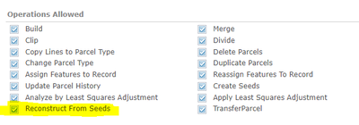

RobertChaney

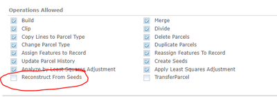

Ok, the operation is initially unchecked by default (not sure why), but once I checked it on, saved and restarted the service, the tool ran successfully.  Thanks.

AmirBar-Maor

RobertChaney
I'm guessing it was unchecked because the service was published under an earlier version.
AmirBar-Maor
@RobertChaney
You are correct. When the service was initially published this capability was not exposed on the parcel fabric REST API. I am happy this resolved your issue.
