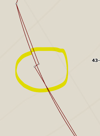

My organization is in the process of implementing the Parcel Fabric and we are seeing a very concerning issue when converting Inactive_Parcel_Lines to Inactive_Parcel (polygon) features.  Below is the workflow:
  • COGO values are entered to create the Inactive_Parcel_Lines (under the Active Record)
  • Once completed, the Build Active tool is run (single-click tool w/ no exposed parameters) to create the corresponding Inactive_Parcel (polygon) features
  • The resulting polygon edges have been smoothed/simplified, with closely-spaced vertices having been removed, and creating curved edges from the straight COGO lines
Has anyone implementing the Parcel Fabric encountered this issue?

All geometries in a geodatabase are 'active geometries'.
Build Active will create polygons from a closed loop of lines and a parcel seed that are associated with the active record. The resulting polygon should match the input source data - meaning that you should not get any topology errors if you were to validate topology.
Did you already submit a case for tech support?
If not - please do. If yes - please provide the case number.
From your screenshot, it is hard to tell:
- The zoom level (a display artifact)
- If the input geometries are valid (GP Check Geometry can help with that)
- The nature of the error (those layers look like publication layers and not editing layers)
- The version of software you are using (Pro and Server)
