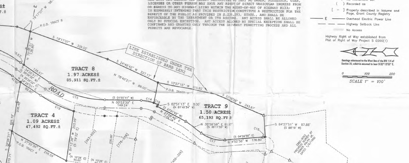

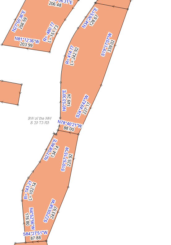

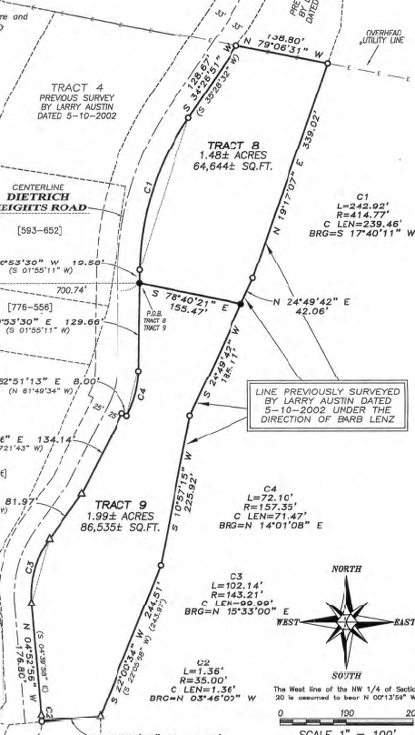

Our current Platted lands has the Original survey metes and bounds
Here is a clip of the Original from 2002:
Here is another survey from 2013:

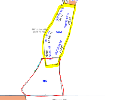

Christine thank you! I will look into the strata parcels because I do believe we had that built in. I guess the reason I am bringing this up is because when I try to build the seeds the lines stop it from building completely. I had this happen in a feature just south of the one in the example above.
The red parcel was the original survey but the yellow parcel would only build to the red line.

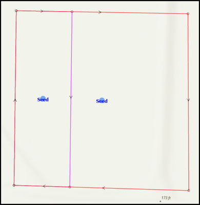

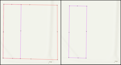

1. The red lines represent a parcel. The purple lines represents an easement crossing the parcel. The lines for the parcel and the easement form enclosures, belong to the same record, but are stored in different parcel types:
2. Seeds are created for both parcels:

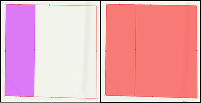

3. Build Active expands the seeds into parcel polygons according to their parcel types, while keeping them in the same record:
