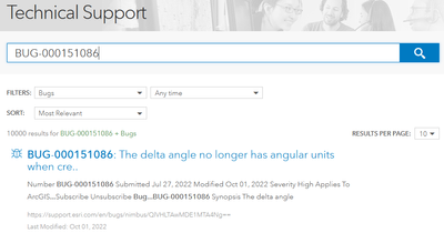

@Eliot_Reid
The bug number is "BUG-000151086"
It has been fixed in ArcGIS Pro 3.1 but has not been ported to 3.0.x yet. I'll update this thread once we patch it in 3.0.
