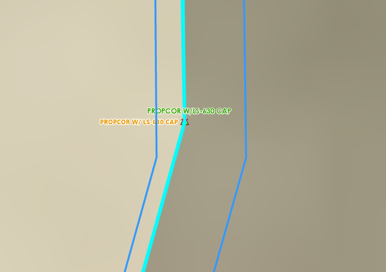

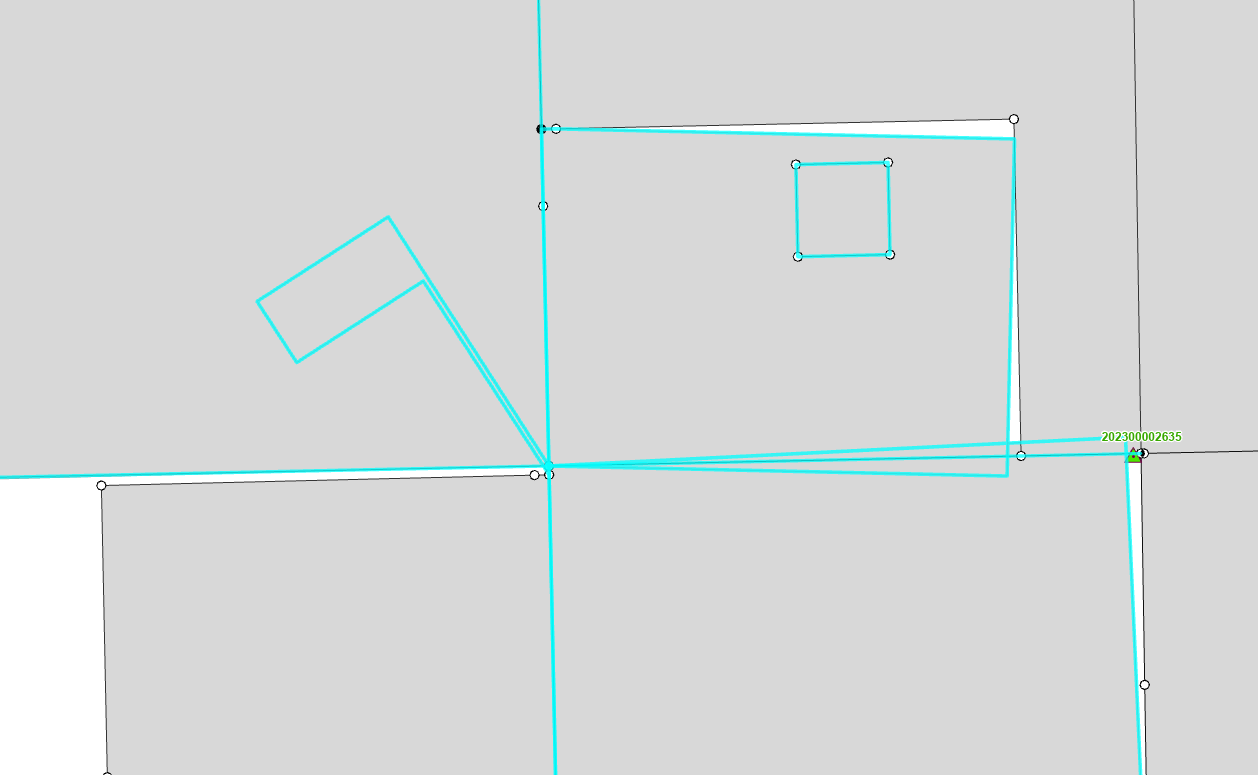

Has anyone encountered this? I use Merge Points in an area where I know the topology is good. No gaps, no overlaps, everything is lined up nicely. The preview shows exactly what I want.
But when I complete the merge, one of the parcels behaves as though it was the other point, while the rest of the features align properly.

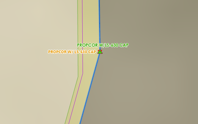

With more points and parcels involved, the results get even wackier:
These examples are easy enough to correct with topological editing tools, but I shouldn't have to do that every time I merge points.
It gets worse. Sometimes the parcels behave as though none of the other vertices are "pinned" by fabric points, even if they are!
This leads to "alignments" in which the entire parcel is transformed in the same was as the target segment, leaving me with literally every other vertex now being misaligned.
Is anyone else experiencing this?
Merge Points used to be my favorite tool, now I avoid it like the plague.

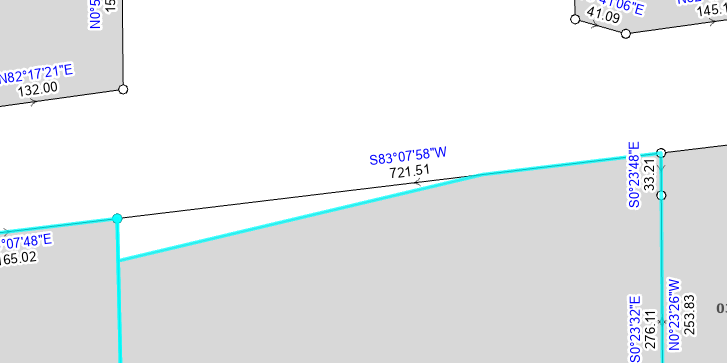

NickN
This is still happening in 3.3.2. I'll merge points and other, unselected, verticies that were tied to a fabric point get untethered. It even shows it's going to do that in the preview.
The "bend" in the subdivision boundaries above get untethered from the corner they were all coincident at when I merge parcel points 90 feet north of here. Then these end up with vertices uncovered by parcel points. Even worse, the result doesn't match the preview lol:
