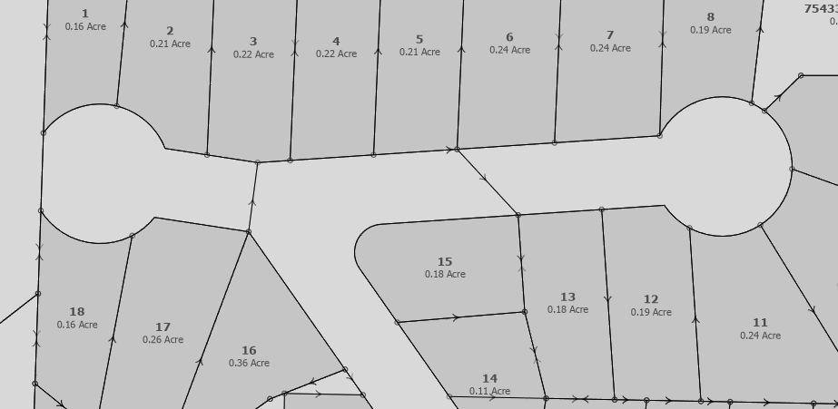

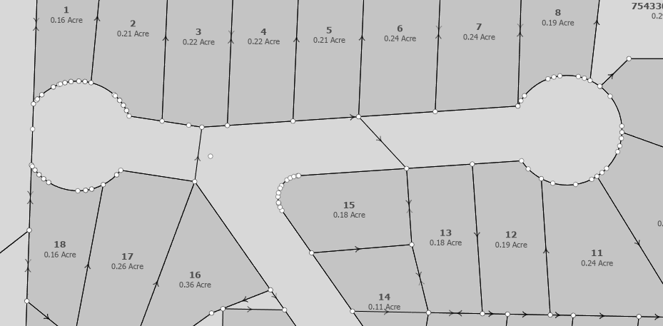

I have followed the instructions for modifying parcels.  Shrink to Seeds, edit, and build.  This works great.  I am able to clean up bad geometry.  However, after building the polygons, the original parcel points associated with them remain.  To clarify the images, this process was done in both lot and parcel polygons.  See before and after photos.  I assumed they would disappear during the re-build, but that does not seem to be the case.  Any suggestions?
This is the fixed, notice fewer vertices on curves.
Points persist.

Thank you for the reply.  In my scenario, first I did Shrink to Seeds.  Then I deleted all the original lines that were present from the original polygons (the densified arc situation).  Next I made all new lines with just the correct amount of vertices.  Finally I did a Build Active.  That is seen in the first screenshot. So when I built active, I was expecting all those points to drop out on the newly built parcels, but they persisted despite the underlying lines that caused them being gone (second screenshot).  The polygons (both lot and parcel polys) are fixed and the lines are too, but the original points remain.
