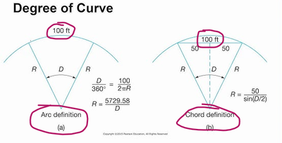

But................................. Here is what degree of curve means. 🤓
On your first call, your curve length is 100 ft if D (internal angle) is 4 degrees.
Arc definition is the central angle for a 100.00 ft arc; chord is for a 100.00 ft chord.
Arc Definition Curve
  • Definition: An arc definition curve is defined based on the length of the arc itself.
  • Measurement: The central angle (often denoted as Δ) and the radius (R) of the curve are key parameters.
  • Usage: This method is typically used in contexts where the actual travel distance along the curve is of primary importance, such as in roadway design.
Chord Definition Curve
  • Definition: A chord definition curve is defined based on the straight-line distance (chord) between the endpoints of the curve.
  • Measurement: The chord length (C) and the middle ordinate (M), which is the distance from the midpoint of the chord to the curve, are key parameters. The radius (R) and the central angle (Δ) can be derived from these measurements.
  • Usage: This method is often used in railway design and other applications where the straight-line distance between endpoints is more relevant than the actual path traveled along the curve.
Key Differences
  1. Primary Measurement Focus:
    • Arc Definition: Focuses on the length of the arc.
    • Chord Definition: Focuses on the straight-line distance (chord) between endpoints.
  2. Parameters Used:
    • Arc Definition: Central angle (Δ) and radius (R).
    • Chord Definition: Chord length (C) and middle ordinate (M).
  3. Applications:
    • Arc Definition: Commonly used in road design where the travel distance along the curve is important.
    • Chord Definition: Commonly used in rail design and other applications where the straight-line distance is more relevant.
