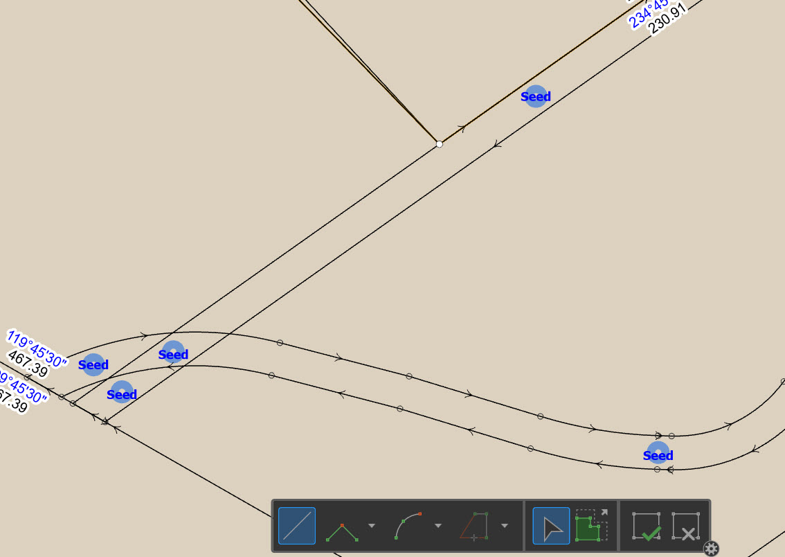

I am using ArcGIS Pro 3.1.3 with a prototype Parcel Fabric Version 5, currently experimenting and practicing in a local drive. I am trying to traverse two intersecting encumbrances from a survey and running into some issues. Typically I construct as lines, generate seeds, and build. This has always worked great, retaining and displaying the entered COGO without issue. However in this instance of intersecting encumbrances, when I construct as lines, the seeds are generated for every segment creating erroneous overlaps and ends. See below.
 (I have turned off the COGO labels to better see the seeds)

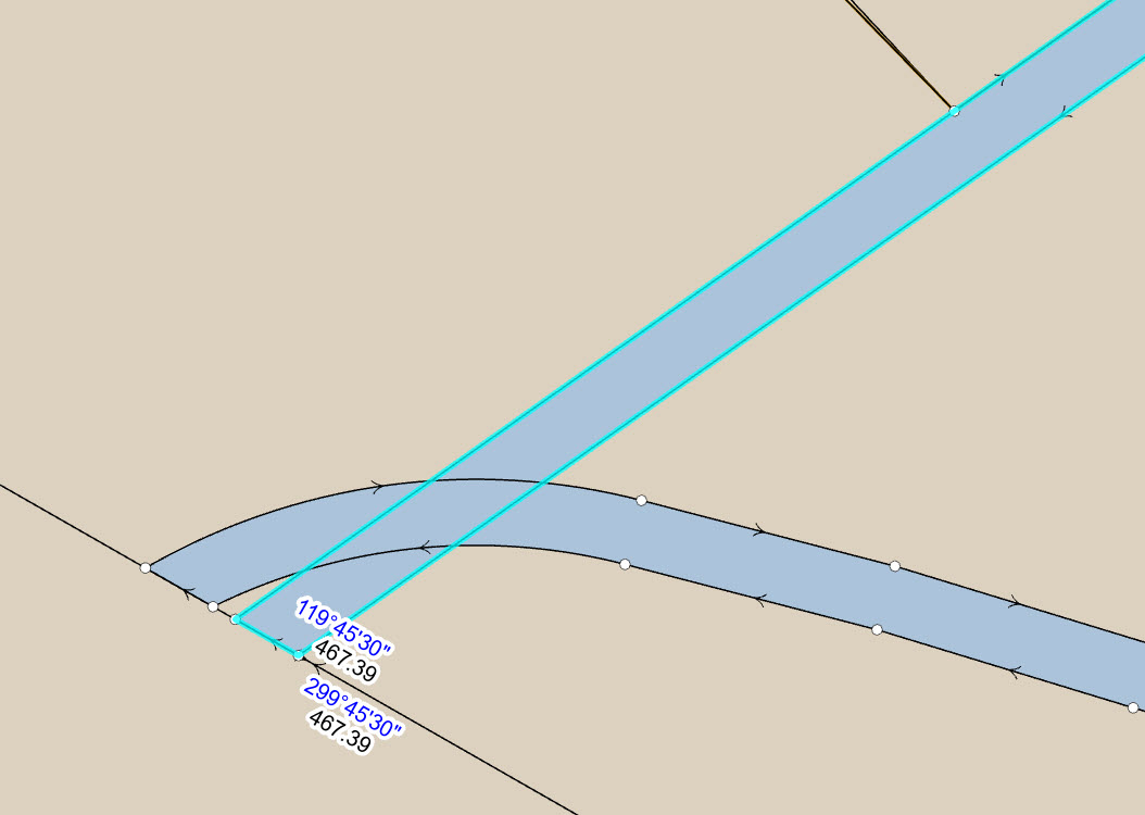

When I construct as lines and build one encumbrance at a time, the first one will build fine but the overlapping one is split into two separate segments, omitting the intersecting segment from the second built encumbrance. This method does retain the entered COGO but does not build correctly. See below.

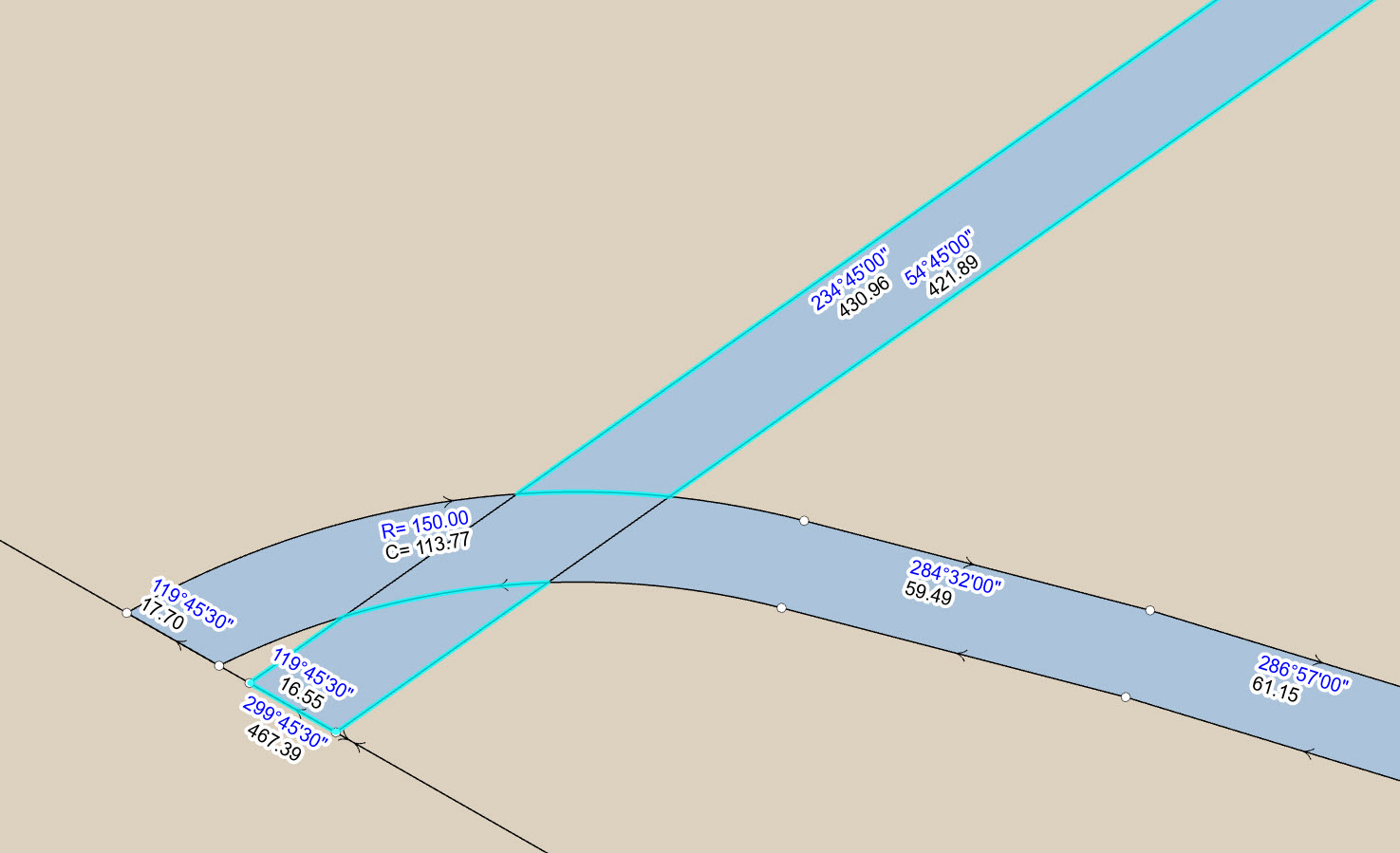

I can solve this issue by constructing as polygons. When I construct as polygons the two intersecting encumbrances build correctly however the entered COGO is not retained. See below.
I ran the ‘Update COGO’ tool on the encumbrances built as polygons however the output measurements are slightly off from the metes and bounds that were entered from the survey.
