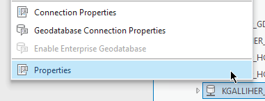

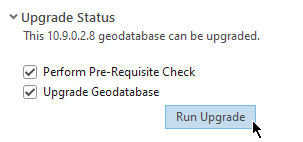

ArcGIS Pro does not force the GDB to be at the same release as the Enterprise but publishing the parcel fabric does. The geodatabase can be upgraded using ArcGIS Pro from the geodatabase properties page similar to ArcGIS Desktop.

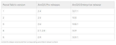

Regarding when to upgrade, as Amir mentioned, if you want to use ArcGIS Pro 2.9, you will need ArcGIS Enterprise 10.9.1.  If you cannot upgrade from your current 10.8.1, the parcel fabric will require you stay at Pro 2.6 as shown in the matrix.

If you want to use ArcGIS Pro 2.9, you will need ArcGIS Enterprise 10.9.1 as this table shows:
