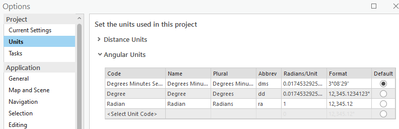

If you will be most commonly using dms for the delta angles set that as the default in the Project > Options > Units > Angular Units.
