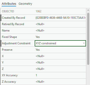

A survey has come in from the field in which some monuments' locations are now known.  I set the "Adjustment Constraint" on those points to "XYZ constrained" on the theory that they should not move.  I then attempted a least squares adjustment for the parcels in the immediate area.  The results of that analysis are here:
I'm only showing one area -- I marked a couple of points as XYZ Constrained.  This analysis shows me that these monuments will move south, including the constrained point.  What I expected to happen, based on previous examples, was that the unconstrained points to the north would move northward.  At the very least, I expected the constrained points to stay put.

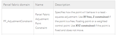

On the moving point... I re-read the docs you linked to... the bits that I'm focusing on are:
and
Based on your suggestion, I tried an experiment where I set "Adjustment Constraint" to "XYZ Constrained" and "Fixed Shape" to "Yes" on these points.  LSA still wants to move them.

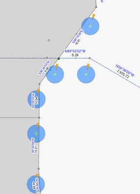

Just one point of clarification.... you mention that it is up to me to determine which points don't move by setting Adjustment Constraint to XYZ Constrained.  I've done this (and also set Fixed to yes), and the point is being moved by LSA adjustment.
Points with constraint set to XYZconstrained are symbolized with the green triangle in this view:
Even if  not constrained, I would have expected that a point with XYAccuracy set to 1 would be encircled in red when the adjustment vector exceeds that (2.25 in this case).

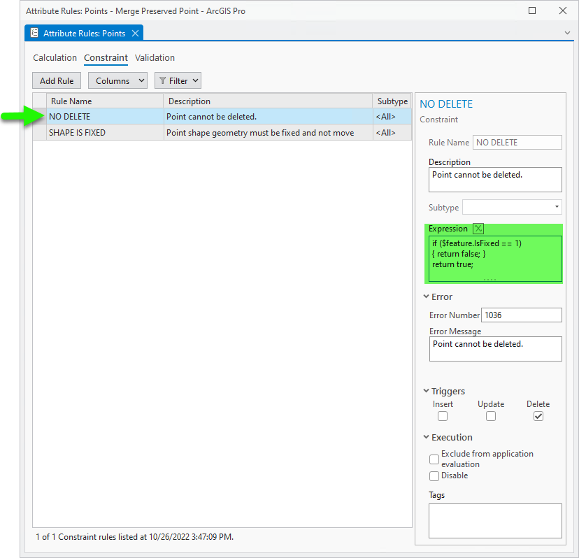

@MahindaAbeykoon- what you describe regarding the Merge Parcel Points tool is not the same problem as outlined in the original description of this post. The good news is that there is also a solution for your case. We have, by default, allowed the merging of multiple points that have their Is Fixed attribute set to "Yes". This allows an editor to accommodate workflows where they need to merge what are sometimes referred to as "porcupine corners" where there are multiple "Fixed" points at a single corner, and they need to be merged. To solve your case, where you'd like to protect from an accidental deletion when merging points, you can create a new Constraint attribute rule on the points, using the arcade expression:
if ($feature.IsFixed == 1)
{ return false; }
return true;
 and inserting it as follows:
