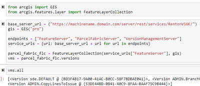

DeanAnderson2
Ken
I think I have figured it out.  IN our example for Part 2 - Branched Versioning for Parcel Fabric when you reference the Service_urls it appears that you may be missing a "/".  The example is as follows:
I got it to work by changing the service_urls to be the following:
service_urls = {url: base_server_url + "/" + url for url in service_endpoints}
I no longer get the permissions error I was getting and will continue to proceed.
