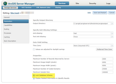

1. Your published service should allow for schema changes

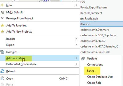

4. To make schema changes you first need to make sure no one is locking your geodatabase.

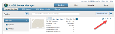

5. You can stop the map service using ArcGIS Server service manager

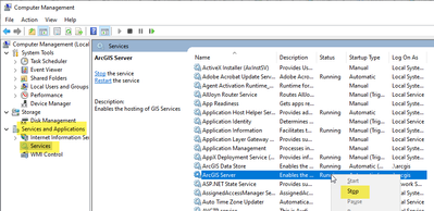

or stop the ArcGIS Server Service (for all published maps) by going to 'My Computer --> Manage --> Services
