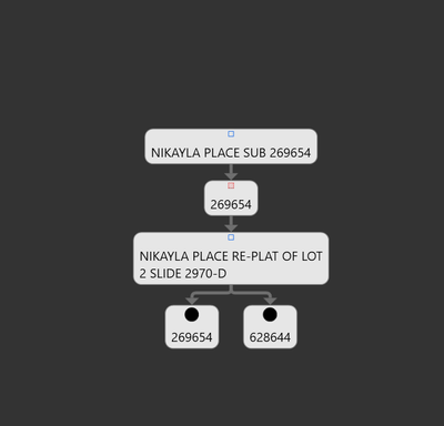

How do I get the parcel lineage to show multiple records, and which parcels they retired. I am confused on how a retired parcel can be shown as the result of one record and then shown as the parent of the next record, as you cannot set a parcel to be a part of two records (unless you can). I found this section on the ArcGIS Blog but cannot get my parcel lineage to show the same and do not want to continue recording these parcels if I am doing it incorrectly. I now think I should keep my record names as the control # so that the lineage shows which division created and retired which parcels.
TLDR; how do I properly assign my parcels to my records to get this result?Screenshot 2024-11-15 134920.png

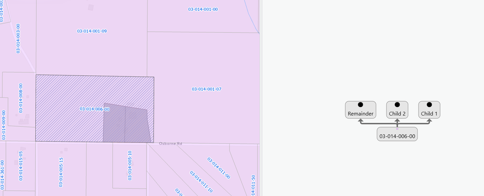

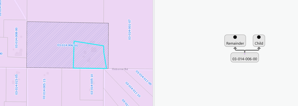

Thank you for responding! I think the issue might be that the retired parcels are not showing up in my lineage? This is the result I get: I started with the larger parcel and the parcel in the bottom right. I created a record and then assigned them. I then turned off that record and merged them and then turned the record back on and set the merged parcel as historic. This gives me the result I want when I view the lineage.
Screenshot 2024-11-15 151355.pngHowever when I do the split of the child parcel, the lineage does not show the first split. How do I properly use the records to have it show both splits in the lineage?Screenshot 2024-11-15 145857.png

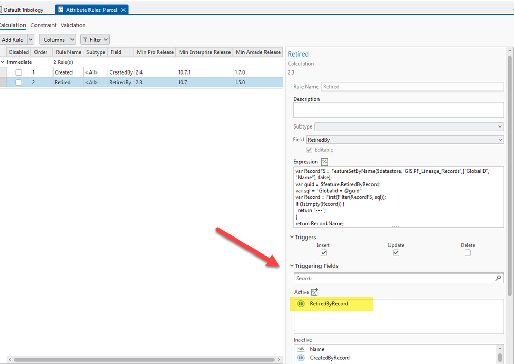

To populate the record that retired a parcel you can use this expression:
var RecordFS = FeatureSetByName($datastore, 'GIS.PF_Lineage_Records',["GlobalID", "Name"], false);
var guid = $feature.RetiredByRecord;
var sql = "Globalid = @guid"
var Record = First(Filter(RecordFS, sql));
If (IsEmpty(Record)) {
  return "---";
return Record.Name;
If you are using 3.4 or higher you can make use of the new triggering fields capability:

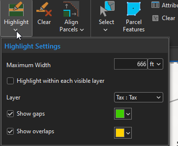

  3. Highlight Gaps and Overlaps: make sure you don't end up with overlapping current parcels by increasing the maximal width tolerance and finding overlapping current parcels.AmirBarMaor_1-1731921128721.png
