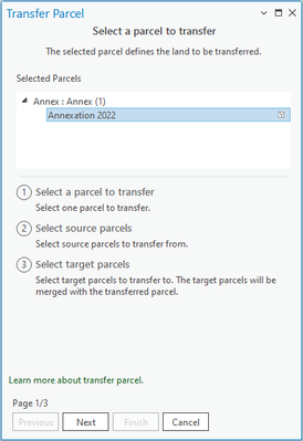

With the ArcGIS Pro 3.0 release scheduled we developed a new tool called 'Transfer Parcel' that will help manage administrative boundaries - specifically an 'Annexation' workflow.
The Transfer Parcel tool will also support other record-driven workflows like ROW vacation and ROW dedication.
Here's a glimpse:
