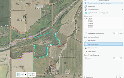

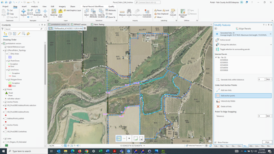

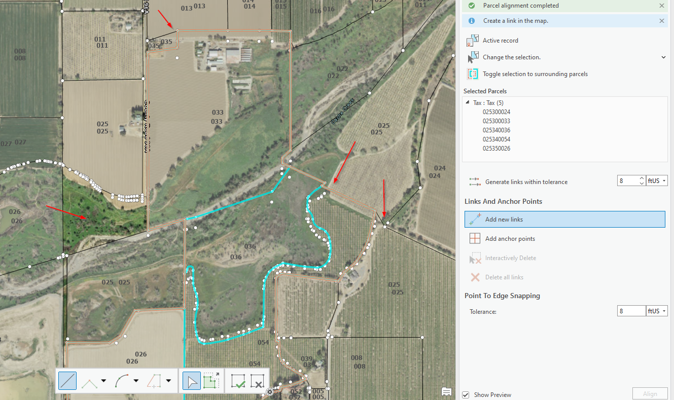

I'm trying to do an align parcels, with the goal of aligning surrounding parcels to the new one I just drew. But even though I've put anchor points on all the places I want to stay put, after aligning, many of those areas have moved. In the second screenshot below, I've put several red arrows next to the areas that got moved that weren't supposed to.
In addition, there's a whole parcel that seems to have been deleted or lost its geometry after the align was run.
Does anyone have any idea why this might be happening, and what I could do about it?

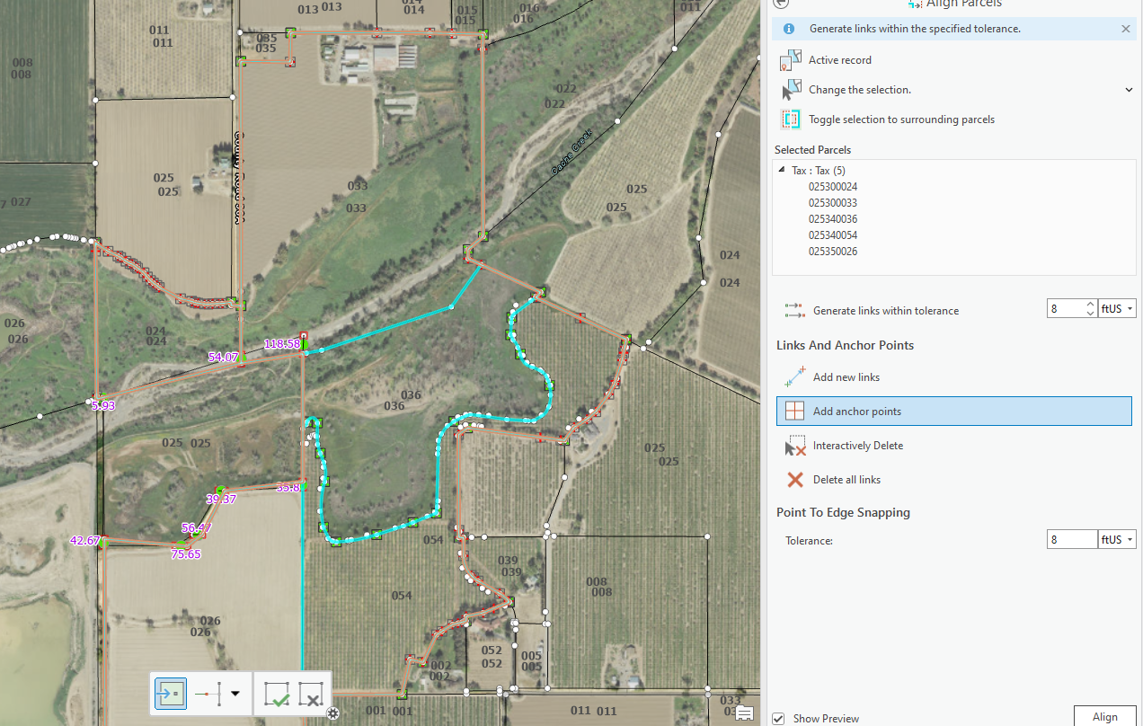

AndrewWallick
Also, here's the preview. It shows the lines respecting the anchor points.
