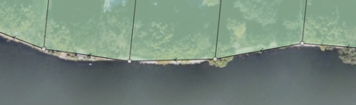

Except, I noticed one little thing: the affected features don't get their "Last Updated" timestamp updated. Here's an area where previously, the parcels had been clipped by a NHD river polygon. When our parcels were converted to the Parcel Fabric data model, literally hundreds of short segments were added to the boundary lines layer, with fabric point features between each.
Legally speaking, these river frontages have a single distance and no bearing, so they were perfect candidates for using the Merge Points tool. I can go back and add vertices to make them look "nice" with the river's edge, but now each is represented by a single line feature, and is in keeping with the recorded documents and plats.
This area has a subdivision, dozens of parcels and lots, as well as historic features. Despite all of them drastically changing their shape along the river's edge, not a single one of them had their "last modified" field updated.
