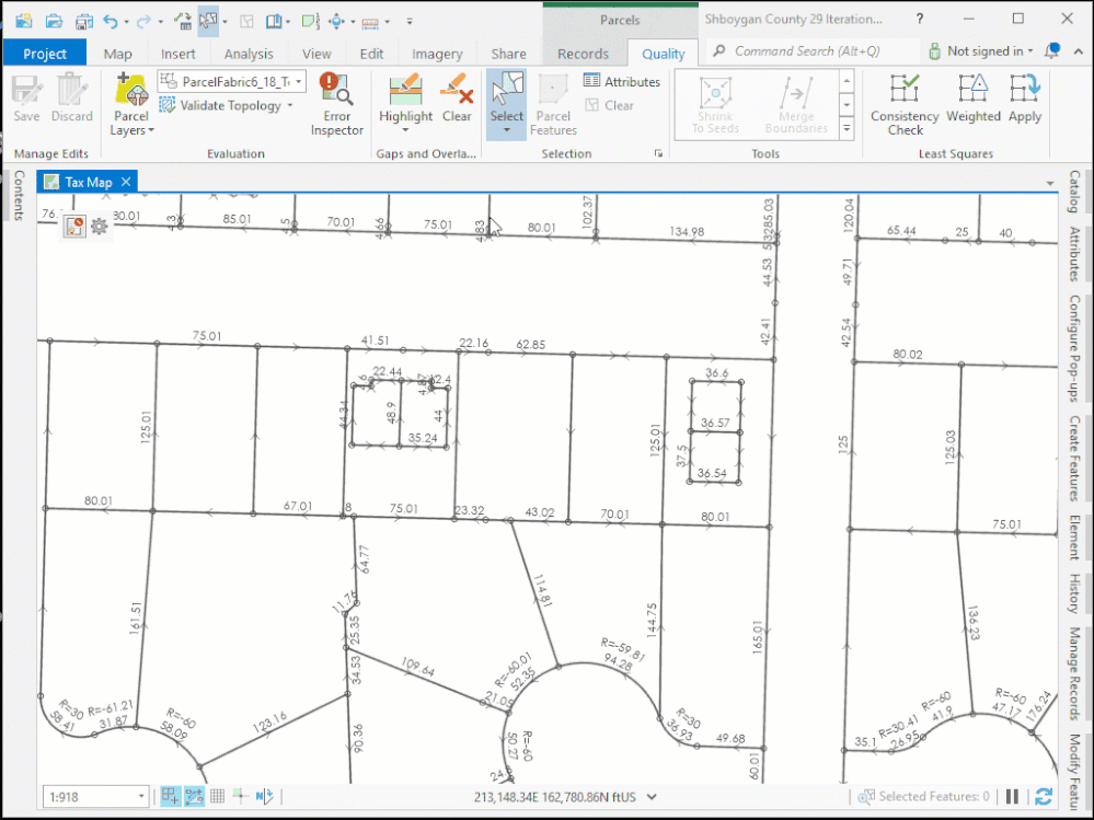

What kind of topology rules are you currently using that make historic parcels an issue? If you are using MUST NOT OVERLAP and/or MUST NOT HAVE GAPS I recommend you take a look at the Highlight Overlaps and Gaps tool.
It highlights overlaps and gaps WITHIN TOLERANCE - which means you can define the width of a valid gap (like roads) or overlap (like condo units).
