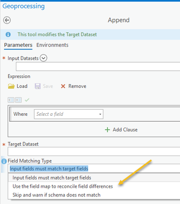

When you use the standard Append tool you have the option to map any fields that do not match, but if you have fields in the source data that are not present on the target - the feature will be appended but their attributes will be lost:

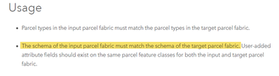

When you use the Append Parcels Tool we assume the source and the target schemas match.
This is documented in the help documentation for the tool - https://pro.arcgis.com/en/pro-app/latest/tool-reference/parcel/append-parcels.htm
