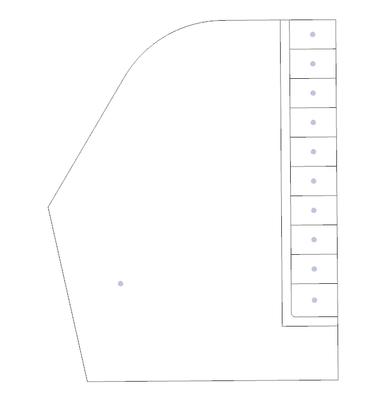

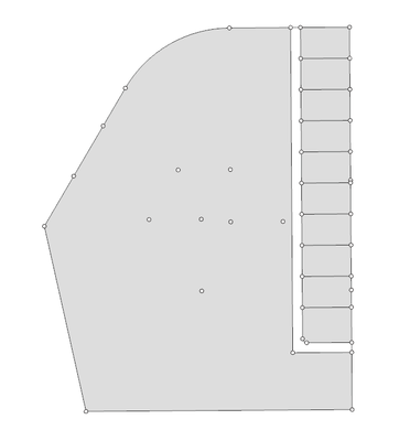

Say I've got a set of parcels like this:
And I have a document that's going to create a new arrangement of parcels within these, but sharing the outer boundaries. My typical workflow would be:
