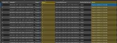

Exactly what it says in the title. Right now, the field Created By Record/Retired By Record has a string of characters that Pro uses but I can't search by it or otherwise identify which record did what outside of whatever the active record is.
Please consider changing this field to reflect the Name field.

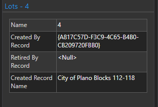

It's possible to use Arcade to show the record values in the popup, or as a label.
var fs = FeatureSetByName(
    $datastore,
    'yourFabricName_Records',
    ['name', 'globalid'],
    false
// I tried FeatureSetByRelationShipName, but Pro didn't like it.
var rec = First(Filter(fs, `globalid = '${$feature.CreatedByRecord}'`))
return DefaultValue(rec['name'], '')
But you still can't search by that value, except in the records layer.
Another alternative is to add a Join between your layers based on the GUID / GlobalID fields:
The major downside to this approach is that you've got to add the join for every single parcel and line layer in the fabric to get at the attributes, and do it twice if you want the same attributes for the retiring record.
Changing the relationship field probably isn't the way to fix this, but it would be really nice if Parcel layers had some kind of popup, label, and/or virtual join in place by default when parcel fabrics are added to the map.

AmirBar-Maor
I have created this post to show different methods of seeing the records records' name.
https://community.esri.com/t5/arcgis-parcel-fabric-videos/see-the-record-name-as-part-of-the-parcel/...
I hope you like it.
